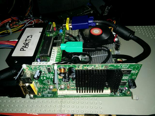

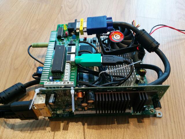

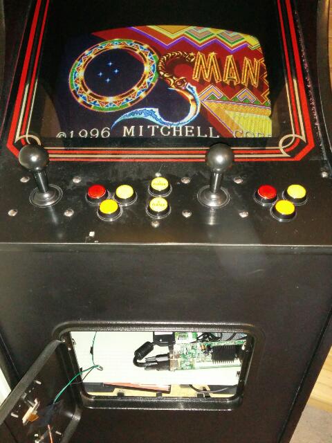

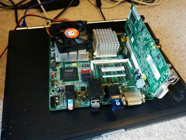

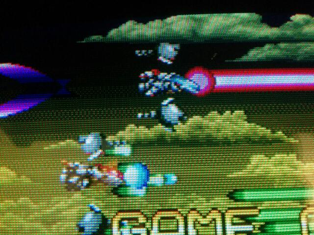

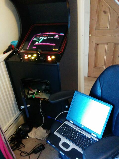

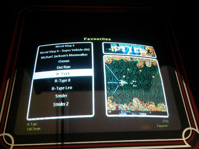

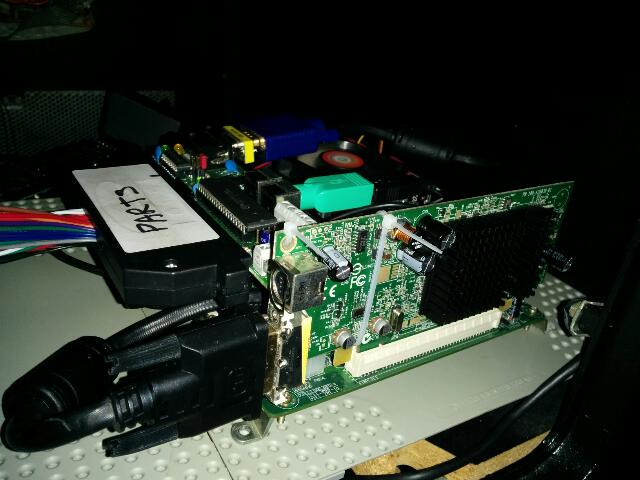

OK, here's the messy prototype of my blue elf/pandora's box killer!
It's got the following features:
  • small! (17x17x8cm, bit bigger than the 15x15x3cm blue elf)
  • cheap(ish) - less than £100
  • powerful - core2duo @2.2ghz with 2gb ram
  • the CPU fan is the only moving part
  • completely powered by the JAMMA PSU.
  • plug 'n' play baby!
  • runs groovymame & groovyume under groovyarcade 64 bit linux
  • thousands of arcade & console games: newest version of mame, snes, md, ms, nes, 2600, jaguar, etc.
  • no screen tearing!
  • native resolutions for each game!
  • no crappy audio!
  • ultra low lag (less than one frame)!
  • update groovymame over ethernet connection
  • completely open - update your roms on the second USB stick. just drag and drop your legally owned roms from your full mame set!
  • need more storage? shove another USB drive in!
  • nice clean frontend (very important!)

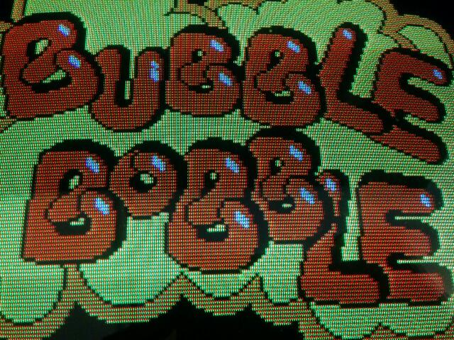

in the cold light of day:
pixel perfect:
Just need to sort the sound out properly - I'm currently using a USB powered amp, but will switch to a 12v one.
If anyone wants a shopping list let me know. How could you spend £70+ on a Blue Elf when you could make this?

Is that frontend part of the GroovyArcade distro ?
2huwman View Drop Down
Joined: 28 March 2013
Location: Isle of Wight
Points: 476
Post Options Post Options   Thanks (0) Thanks(0)   Quote 2huwman Quote  Post ReplyReply Direct Link To This Post Posted: 30 January 2015 at 8:17pm
Originally posted by The Last Bandit The Last Bandit wrote:
Looks cool !!
Yeah, it's on the newest beta. It's called attractmode. The 'basic' layout is the one in the photo and the best one IMHO.

It performs really well. I haven't tested it extensively, but it runs all the 8 and 16 bit games I've tried. All the ones on the favourites list run perfectly (Strider 2 might have stuttered once or twice at the start Edit - and fairly regularly slows down - so best stay away from the 3d games, unless you want to use frameskip, which kind of defeats the point of doing this!).
I thought it might struggle with outrun and moonwalker, but no problems at all. So neogeo, cps 1 & 2, sega system 8 & 16 and equivalents should all be fine. I tried soukyugurentai and that slowed down. STV emulation isnt good in mame though, and groovy arcade does provide alternative emulators so I'll give that a try.
It's all Linux based, and GroovyArcade guides you through all the setup. You just burn the GroovyArcade CD, and use that to install to whatever storage you're using (obviously using an external CD drive for the installation, which you won't need to connect after that's done!).
I need to sort out my mame romset and artwork properly. I guess the USB drives could be cloned, but you'd need to have the exact same hardware, as GroovyArcade would install specific drivers. Basically, the easiest thing to do is install GroovyArcade to a small (4 or 8gb) USB drive from the CD, and point it to a big (e.g. 64gb) USB drive during the setup where all your roms are.
Happy to provide more detailed guidance as and when! I had been going to ask you if you'd be able to do a JAMMA edge passthrough that splits off the 12v. I'm currently using the 12v line that went to the coin mech on my cab, but it would be neater from the edge connector!

I've been looking at the power side of things and I'm a little concerned with running it all from the JAMMA edge/PSU. I'm not sure which Pico PSU you're using but looking at the specs they need 2A minimum. Im not sure how much power you're using but even at 40watts you're looking at over 4A, 80watts would draw over 8A. Looking at a few JAMMA switchers on the net they seem to range from about 2-5A on the 12V line.
You might want to measure how many amps you're pulling. You can do it with a multimeter if you have one.
It might be a better idea to use a separate 12v PSU for the Pico, although if you're doing that then it might be cheaper to use a small ATX PSU. It's a shame to have to use an external PSU as I would love to run it all from the JAMMA edge but I'm just a bit worried about damaging the JAMMA PSU. Just had a quick look at some of the XXXX-in-one JAMMA systems which I guess is similar to what we're doing here and they look to be using ATX PSUs.
