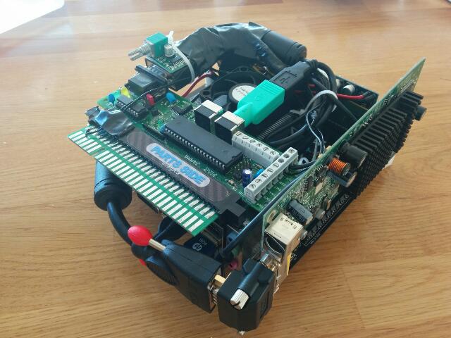

I've got v2 of the miniKAB (Kick-ass Arcade Board!) going using the newish AM1 platform. Had to buy the parts separately and put it together, but it's a lot easier installing a CPU than I was expecting!
The bad news is that the integrated GPU isn't fully supported by the linux open source drivers yet. I got it to output a 15khz picture, and managed to get one or 2 games going, but it's laggy and crashes. It's a shame, as it was running at less than 20 watts. Hopefully the drivers will be updated and it'll be supported in newer versions of GroovyArcade.
But the good news is that even with an external GPU, it consumes very low power. It hits 29 watts in the first few seconds of startup, but then 20 watts or lower in the menus, and 25 in game. I had to overclock the athlon CPU to 2.1ghz, but all the cps 1 & 2, neogeo, and sega system 8 & 16 etc games work perfectly. I get the feeling there's not a lot of headroom though, and it seems marginally less powerful than the much older v1 core2duo system (although I'm sure that's a lot more power hungry (I'd guess 50 watts, but haven't measured it).
So it's pretty close to the plug 'n' play dream. I've been running it off my JAMMA PSU without any problems. I've got some better cabling on order to tidy it up, and a smaller audio amp coming.

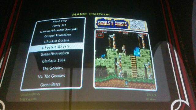

I've been setting up some of the console emulators (SMS, MD, and SNES all work). The performance is more variable than MAME. most work fine, but have the odd hiccup.
The GPU & CPU cost £70, so not cheap, but not too bad. I'll do some more pictures when it's finished!
2huwman View Drop Down
Joined: 28 March 2013
Location: Isle of Wight
Points: 816
Post Options Post Options   Thanks (0) Thanks(0)   Quote 2huwman Quote  Post ReplyReply Direct Link To This Post Posted: 22 February 2015 at 9:15am
Here's a few more pictures of the finished v2 miniKAB:
The JAMMA edge passthrough adapter takes the 12v to the mobo, and the 5v to the little sound amp. It runs at 25 watts, and I've had it running for many hours off a standard PSU which provides 2.5 amps on the 12v line. So in theory, up to 30 watts should be OK? It would be nice if the discrete GPU wasn't needed, but that might change with updates to GroovyArcade.
Most of the hassle has been setting MAME up properly. I've finally stripped out all the Mahjong/Casino/Titillation, and set up lists for my favourite genres:
Also got lists for Megadrive, Master System, SNES, and Favourites.
So it does everything I wanted it to, and only needs plugging in to the JAMMA edge connector. It starts when I power the cab up, and there's no need to shut it down separately, so just unplg the cab when you're finished! I might use and SSD instead of a USB memory stick to make it a bit quicker to load up. Takes about 35 seconds from power on to the game lists currently.
A fair amount of hassle, but worth doing if you want a superior multiboard experience!
